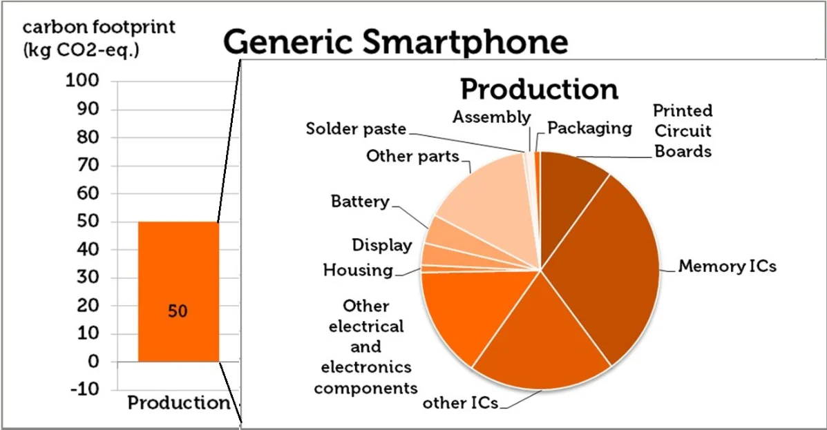

Expected carbon footprint breakdown

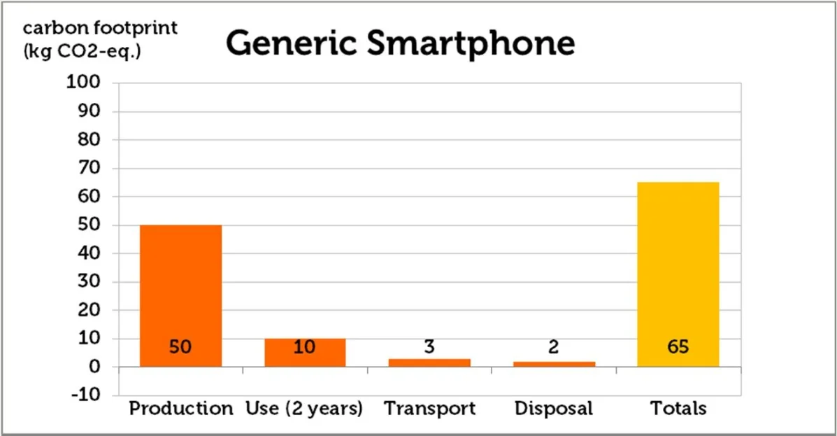

One of the most common questions about a product’s footprint is about greenhouse gas emissions. These are mainly related to the highly-complex production process – and less about how a phone is used (eg, how much electricity it consumes). That means, a device should be used as long as possible! I’m including the graphics below to give an overview of the carbon footprint of a generic smartphone (production, use, transport, and disposal).
Below you can also see a more-detailed explanation for what carbon footprint is created from the many aspects of the production process.
Credit: Karsten Schischke (LCA to go)
As anything that extends the lifetime of a phone is good to lower overall carbon emissions, we can take 2 specific examples in this year’s Fairphone that will extend the phone’s life: dual-SIM capability, and external microSD storage.
Further, certain decisions like NOT making a charger/cable as default – could greatly reduce the generation of e-waste, and Karsten suggests it could save 1 kg of CO2 related to the production of the charger. Although 1 kg is only a small fraction of the total footprint, it is still a bit of an improvement. It also explains why Fairphone has made a cable charger optional for consumers, to reduce unnecessary waste and greenhouse gas emissions by giving people a cable that they might already have in their homes.
