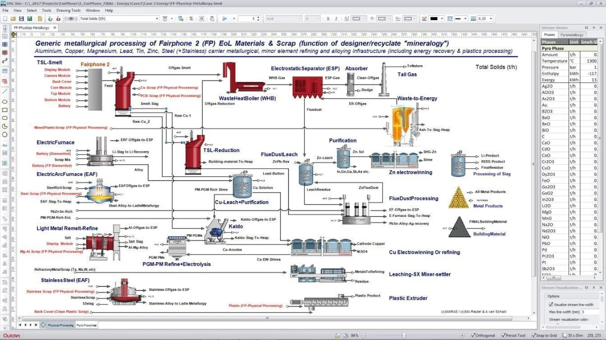

To find out, van Schaik and Reuter started with the wealth of information from the full material declarations we’ve collected from all the (sub-)suppliers we could reach, and combined it with the powerful HSC Sim 9 metallurgical and physical separation process simulation software from Outotec. The software allowed them to create models of how all the different elements, alloys, plastics and materials associations in the Fairphone 2 behave in the best recycling technologies available today and which existing techniques could offer the highest recovery rates.
The sophisticated models they produced not only show what could be recovered – they also reveal what is lost, and at which stage of the recycling process, because the simulations captured the full composition of scrap particles. For example, some processes cause complete loss of magnesium due to oxidation, while others might cause all the plastics to be used as fuel instead of being recovered.
Note: The figure below shows the simulation and modeling process of the metallurgical processes. We have also investigated shredding and physical sorting. For this and more detail, please read the full Fairphone Recyclability Report.
Figure 1: The metallurgical, energy and plastics processing flowsheet that can process the multitude of metals, alloys, functional materials and plastics in an end-of-life product. It covers steel, stainless steel, copper, lead, tin zinc, aluminum and magnesium as carrier metal metallurgical infrastructure as well as plastics recycling as well as energy recovery.

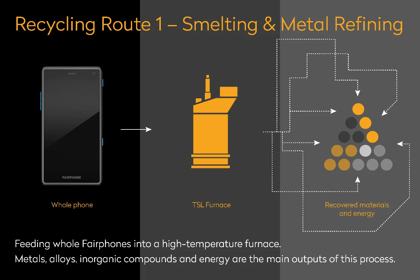

Route 1: Smelting
Total smelting: Feeding whole Fairphones into a high-temperature metallurgical furnace, recovering the materials mainly as metals, alloys and inorganic compounds while also using embodied energy of plastics.
Figure 2: Shows a simplified view of the first route. For the full story check Figure 1.

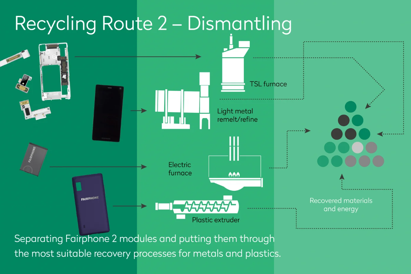

Route 2: Dismantling
Selective smelting: Separating Fairphone 2 modules and putting them through the most suitable metallurgical and plastic recovery processes. For example:
  • Camera, core, top and bottom modules go to top submerged lance (TSL) furnace
  • Display module goes to light metal remelt/refine, for optimal recovery of materials such as magnesium
  • Battery goes to an electric arc furnace (EAF), for optimal recovery of materials like lithium and cobalt
Figure 3: Shows a simplified view of the second route. For the full story check Figure 1.

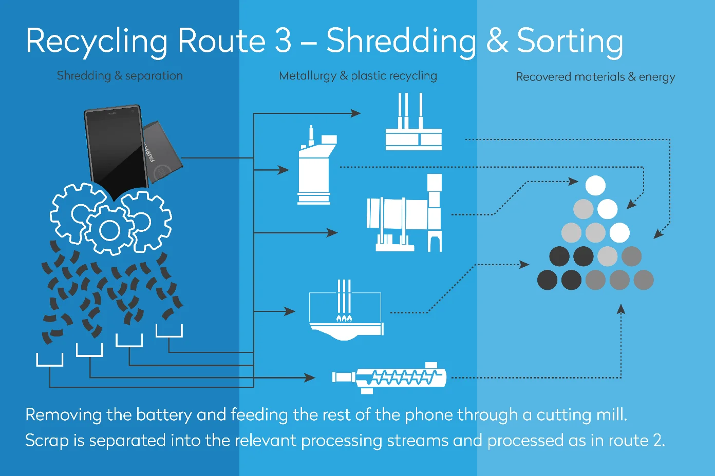

Route 3: Shredding & Sorting
Physical processing and metallurgy: Removing the battery and feeding the rest of the phone through a cutting mill. The resulting scrap is then separated into the relevant processing streams (metallurgy, refining and plastic recovery).
Figure 4: Shows a simplified view of the third route. For the full story check Figure 1.Analyzing these routes allows us to reveal the effect of product complexity and understand how modules and scrap are processed in metallurgical, plastic and energy recovery technologies[MR1] [MB2] . An overview of all the processes involved in detail can be seen in the flowsheet below. For more information please review the white paper attached.

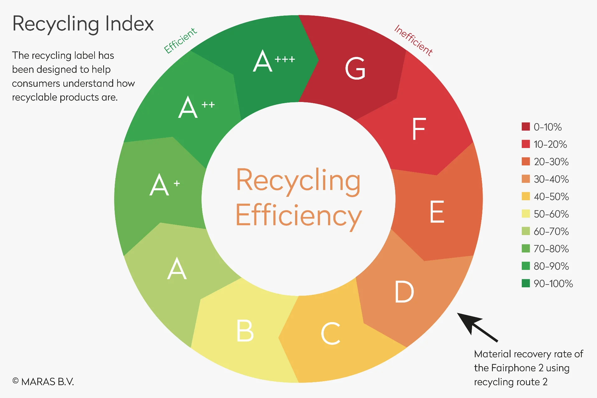

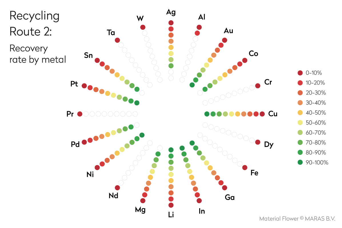

Therefore, based on the combination of variety of recovered metals and recovered reusable plastics and the effort that has to be put in physical processing, recycling route 2 is the best option for recycling the Fairphone 2. It also comes out on top when you consider environmental impact and energy recovery, which we’ll cover in more detail in the next blog post in this series.
And because this method relies on partially dismantling the Fairphone 2 and its modular components, it offers a strong argument in favor of our modular design approach. In addition, the modular construction improves the recovery of specially valuable minor elements such as gold, rather than just bulk metals.

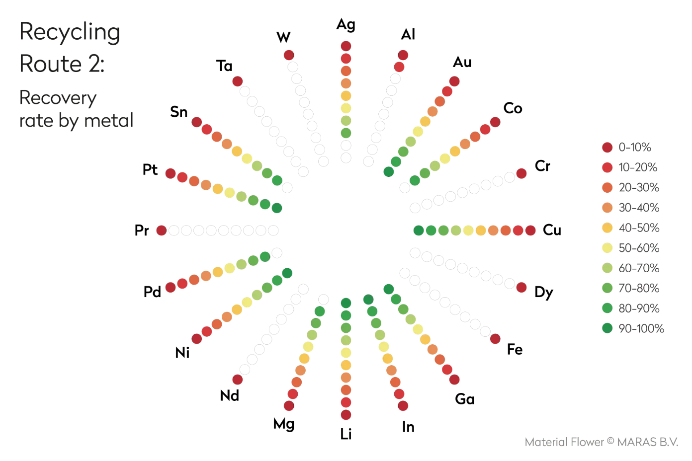

Figure 5: The above Material Flower shows the percentage of materials recovered using Route 2; developed by Van Schaik and Reuter. Percentages are based on weight of all 20 selected materials.
The recovery percentages of the three different routes represent very high-level findings that include all of the materials in the Fairphone 2. But the results of the study also revealed some great insights about recycling rates of individual materials. Here are just a few examples:
  • Materials such as gold, copper, silver, cobalt, nickel, palladium, platinum, gallium, indium and zinc can all be recovered in high percentages (80 to 98%), and modularity promotes their recovery.
