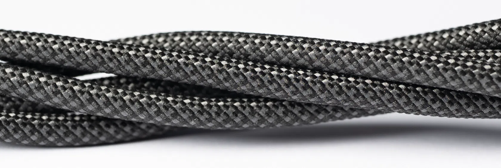

We recently launched our new line of durable and sustainable cables and chargers, which were received with much appreciation across the tech world. Not only are they faster and safer than its predecessors, they are made fairer too, using more fair and recycled materials, contributing to our living wage bonus program, and assembled using green energy. And like all other recent launches from Fairphone, they are 100% e-waste neutral too.
The new USB-C 3.2 Long Life Charging & Data Cable and USB-C Long Life Charging Cable are both super strong cables, clearing 100,000 and 70,000 bend tests respectively. On the other hand, the 65W Triple-Port Fast Charger and 30W USB-C Fast Charger are powerful where it counts, yet compact enough to take on the road. In fact, the form factor on the 30W fast charger is so small, it fits into your pocket! They are also universally compatible, supporting multiple charging protocols, and come with an integrated USB-A adapter for legacy devices.

Yes! The test results show that the resistance thresholds for cables and chargers go far beyond those of other products on the market.
In fact, the durability stakes for a cable and a charger are very much based on reliability, as there are few repairability stakes for these products (low price, few parts, etc.). The major stresses on a cable are mechanical torsion and tension, and connection/disconnection cycles. We all put our charging cables through their paces every day!
Fairphone charging cables withstand over 20,000 twisting cycles, which represents more than 10 years of cable use if used every day ! The cables also withstand 70,000 bending cycles, 10 Kg of tension, 10,000 connection insertions… For comparison, on average, Fairphone cables are six times more resistant than the best cables tested in this study !
In addition to mechanical stress, they are also resistant to UV stress (when you leave your cable in direct sunlight) and chemical stress (when you have sweat or products on your hands, such as suntan lotion). So nothing has been left to chance in terms of the stresses applied to the product and the tests carried out in front of it.
