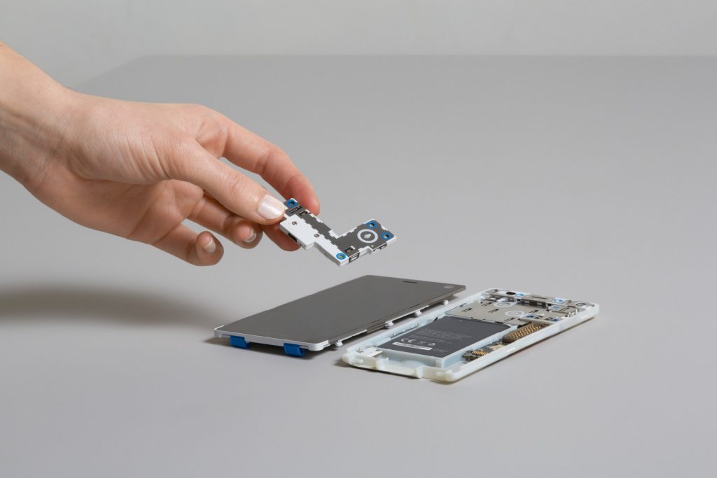

Therefore, based on the combination of variety of recovered metals and recovered reusable plastics and the effort that has to be put in physical processing, recycling route 2 is the best option for recycling the Fairphone 2. It also comes out on top when you consider environmental impact and energy recovery, which we’ll cover in more detail in the next blog post in this series.
And because this method relies on partially dismantling the Fairphone 2 and its modular components, it offers a strong argument in favor of our modular design approach. In addition, the modular construction improves the recovery of specially valuable minor elements such as gold, rather than just bulk metals.
