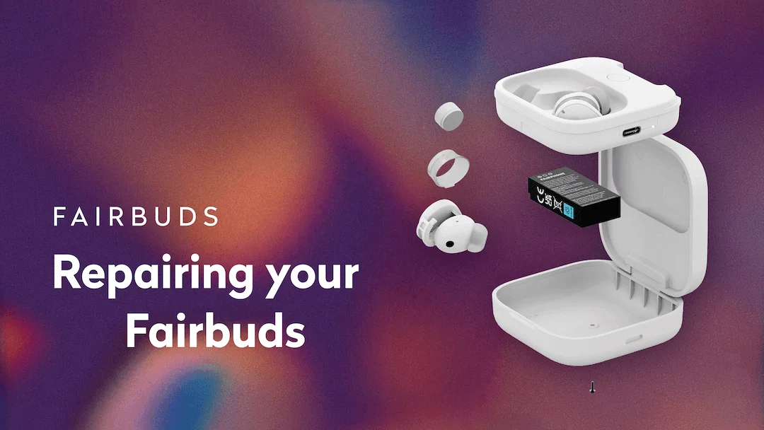

Repairing the new Fairbuds
We’re so proud of the Fairbuds, our first fully modular earbuds that are all about premium sound, designed to last. With seven replaceable parts, removable batteries in the earbuds and the charging case, and a three-year extended warranty, the Fairbuds are built to go on and on and on.
Here’s a detailed step-by-step guide on repairing the new Fairbuds. All you need is a standard Philips screwdriver. A prying tool, like a pair of tweezers or this plastic triangle, will make opening up things easier, but it isn’t essential. Keep in mind, before you start repairing your Fairbuds, make sure they’re not charging or attached to a device with a cable. Also, make sure you’re working on a flat surface.

Replacing the charging case battery is easier than the earbuds. Flip the case over and remove the screw at the bottom of the case. Now open up the cover and remove the charging case core from the outer shell. You should find the battery case at the bottom of the charging case core. Remove the old battery and insert a new one. Put the charging case core back in the outer shell, close it up with the cover and screw it back into place. There! You’re done. Again, don’t forget to properly dispose of your old battery.
REPLACING THE CHARGING CASE OUTER SHELL AND CORE
We have made the outer shell and core two separate parts to keep the electronics inside the charging case as safe as possible. To replace the outer shell, you flip the case over and remove the screw. Now remove the core and place it inside a replacement shell and tighten the screw back in place.
The charging core is what contains all the electronics of your charging case as well as the battery tray. If you feel there are charging issues with your Fairbuds and the battery is working fine, the problem might be the charging core, which is also replaceable. Like with the charging case battery, flip the case over and open up the screw on the back. Now remove the old charging case core and remove your working battery. Slot it into the new charging case core, put it back inside the out shell and close the cover. Screw it back into place and you’re done.
