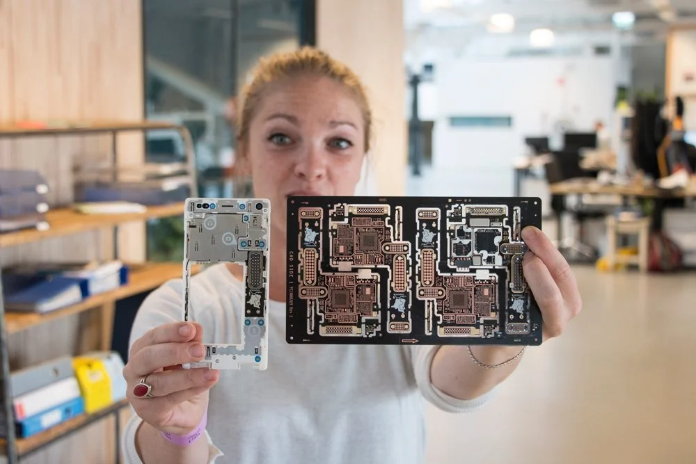

Along the way, we discovered that a smartphone contains about 30mg of gold, 6-9mg of which is found on the printed circuit board (PCB). With a very advanced view on sustainability, AT&S, our PCB manufacturer, was keen to join forces to explore the possibility of connecting Fairtrade certified gold to their supply chain – not just for the Fairphone 2 (which is calculated to be only 100 grams in gold salt for 100,000 PCBs), but perhaps for PCBs produced for their other clients, as well.
The gold found on the PCBs is applied using an electroplating process, which means that AT&S dips parts of the PCBs into a liquid solution that contains gold. The gold in this solution comes from adding grains of gold salt – so the next step back in the chain was connecting with the supplier of gold salt: Zhaojin Kanfort. After hitting a dead end with our earlier attempts to trace Fairtrade gold into China (because all of the country’s gold is traded through the Shanghai Gold exchange), Zhaojin Kanfort was able to provide us with a solution. In short, they are able to import Fairtrade certified gold through their head office in Hong Kong and then trace it to their gold salt manufacturing facility in Yantai, China.
