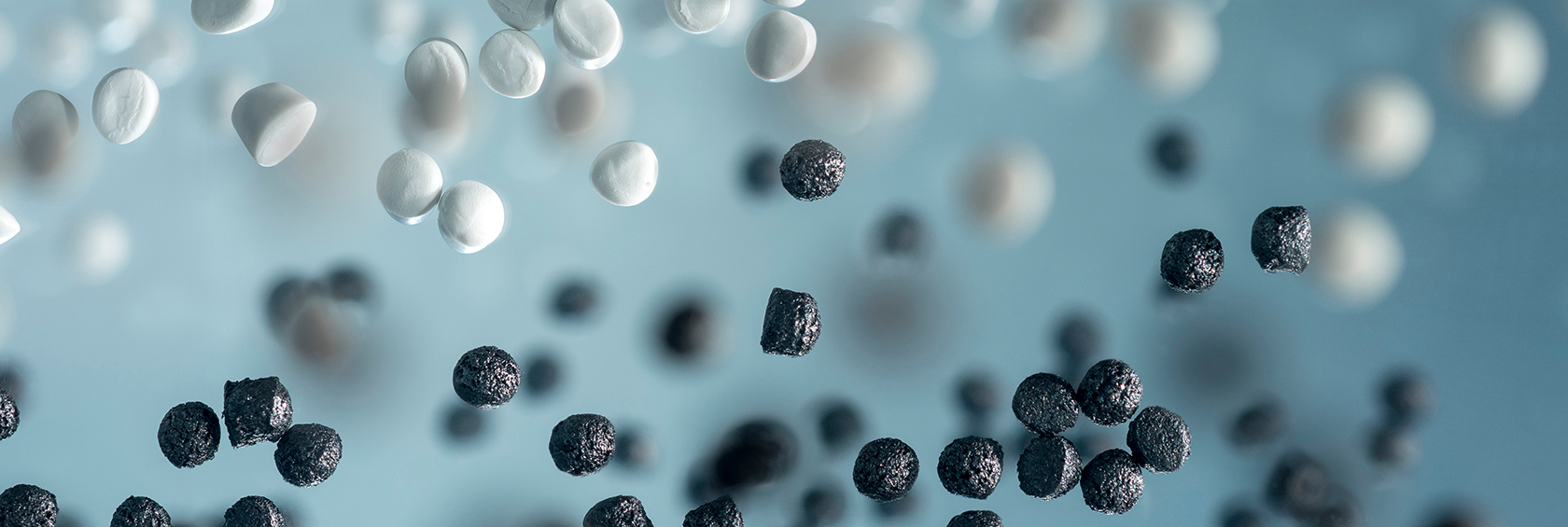

A render of polycarbonate granules
Polycarbonate granules (Makrolon) – Image rights: Covestro AG
However, things have improved by leaps and bounds in the last few years within the plastic recycling space. Big polymer giants like Covestro and Sabic have made major advancements in quality control, especially when it comes to PCR plastics for smartphone manufacturing. The recyclers they work with are held to a high standard, with a major push to standardize the quality of the recycled plastics, including the colors and so on. Even five years ago, these big players would find it much harder to push PCR among electronics manufacturer, given the demands for virgin-like features such as exact color matching and absolute transparency. However, now, it isn’t as hard a sell anymore, especially with new techniques and trends like chemical recycling and PFAS-free PCR. Chemical recycling involves breaking down the original waste plastic to its molecular form, making the resultant PCR almost identical to virgin plastic. And PFAS? Most of the plastic fire-retardant additives in polycarbonate contain PFA (or per-and polyfluoroalkyl) substances. However, PFA substances are also dubbed “forever” chemicals because they are notoriously hard to break down, which means they are terrible for the environment. The EU is already making moves to ban PFAS completely, so there are already requests from many manufacturers (including Fairphone) to recyclers to make PFAS-free PCR that is still fire-retardant.
