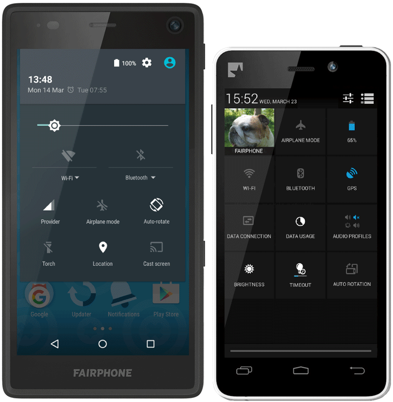

Access the Quick Settings pull-down menu for Fairphone 2 (and 1),by swiping down with two fingers from the top of the screen
1. Adjust your brightness
Using your screen requires a lot of energy, especially with a large, 5 inch screen. You can reduce the amount of energy required by adjusting the brightness. You can dim the brightness level of your screen by opening the pull-down menu. Slide the little sun icon to the left to dim your display (Fairphone 1: touch the sun icon to switch between different brightness settings).
You can also access more advanced brightness and sleep settings under Settings > Display. Here you can turn on Adaptive brightness (Fairphone 1: Automatic brightness), which automatically adjusts the brightness on your screen to the ambient light. You can also adjust how quickly your phone goes into sleep mode – to save energy, pick a lower time period like 30 seconds.
Brightness bar on the Fairphone 2 and the Fairphone 1
