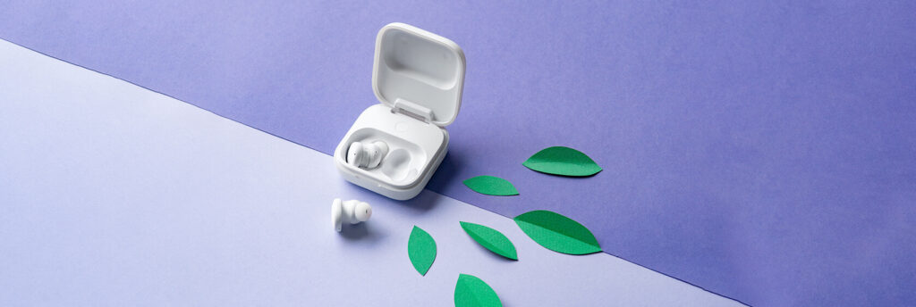

The New Fairbuds
Titanium is key: The new Fairbuds feature 11mm titanium-coated drivers for better, cleaner, richer sound. During the development process, we evaluated several different driver types. This was done from both from an objective perspective, measuring and comparing frequency curves and harmonic distortion, as well as a more subjective approach, in the form of listening tests. We zeroed in on titanium as it is low in density but high in strength. That means our earbud drivers remain lightweight and ensure superfast responses, but are also strong enough to resonate high-fidelity, high-quality, crystal-clear audio.
Peak sustainable design: Designing the Fairbuds was a challenge in itself. We wanted to make it as small as possible, make sure the batteries were replaceable, all while still retaining our IP54 sweat and moisture rating. We also wanted to move away from the ‘stick’ design that wasn’t as user-friendly as we liked. Experience told us that modularity usually meant a larger form factor. We used that to our advantage, increasing the size of the earbuds where ergonomics would not be compromised. For the battery, while we did want it to be replaceable, we didn’t want to make the battery holder completely removable as it would run a high risk of getting lost or broken.  So we came up with a rotating battery tray, one that was easily accessible by using a screwdriver or even a fingernail. We put a silicone ring around the earbud to secure the tray even further and to prevent any dust or moisture from getting inside. On the white Fairbuds, the silicone ring is transparent, hinting at the modularity inside. While the battery replacement process is not as straight-forward as the Fairphone 4 or 5, the idea is that you would be doing this process once every two to three years. The end result is an absolute stellar example of sustainable design.
