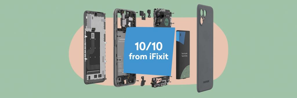

Last week at iFixit we did a teardown of the Fairphone 4, which earned an exceedingly rare 10/10 on our repairability scale. During that teardown, I was impressed with many of the decisions the Fairphone design team made. With repair legislation around the corner in most markets around the world (and already in effect in some places like France) there has never been a better time for smartphone makers to take a few notes from Fairphone 4’s design, and this company’s methods. Here are some that stuck out to me during our teardown.

No part of Fairphone 4 is glued shut, so you can choose to easily repair it yourself with a standard screwdriver.
Scale that concept down to smartphones, and you’re looking for modularity in critical components to a device’s functionality, such as the screen, cameras, ports, and battery. Fairphone 4 gives users access to all these components and more, in just a few simple steps, requiring only a Phillips screwdriver and their fingers.
