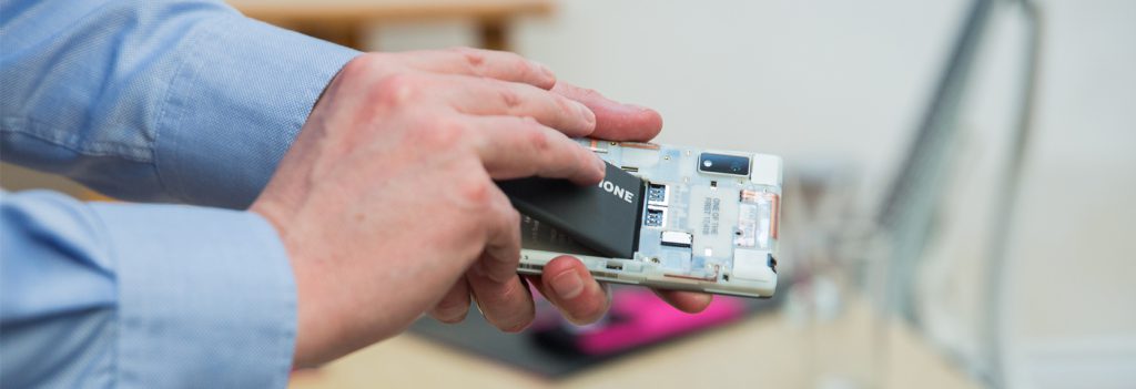

Let’s get straight to some tips on how to optimize the performance of your Fairphone battery. Every battery has a limited lifespan – it will only last for a certain number of charge cycles. And certain functionality, like the screen and data connections, will drain your battery in no time. So the key to ensuring that your battery performs well for as long as possible is to extend the amount of time between charges. Below you’ll find a selection of tactics we use to make the most of the Fairphone’s battery life.
* Note: We’ve created the animations/photos below using a Fairphone 2 and Fairphone 1 because the exact functionality can be slightly different.
