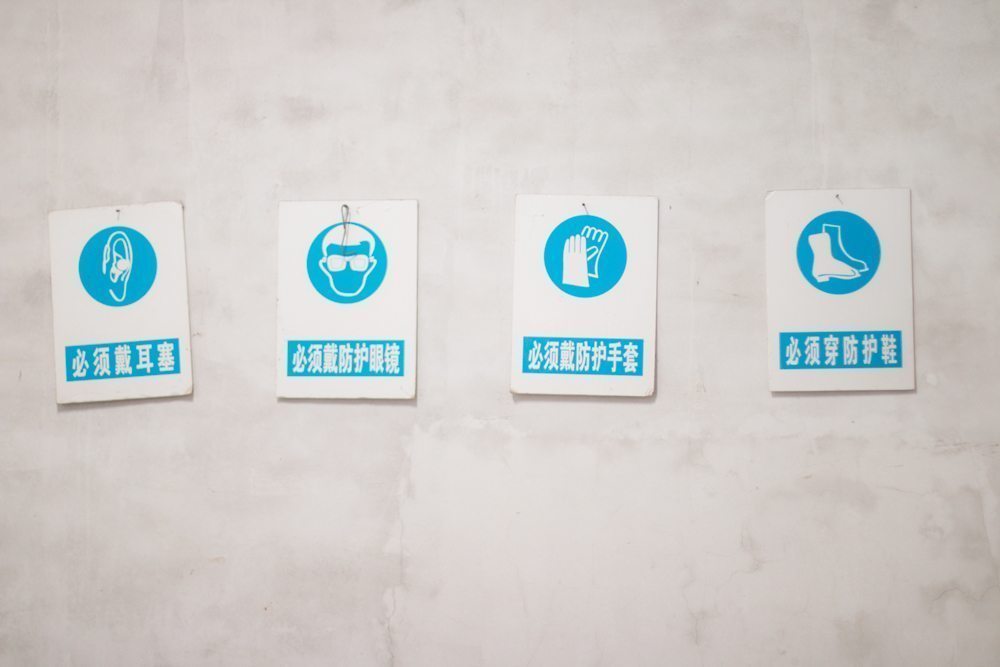

Signs to ensure proper usage of personal protective equipment at the Hi-P facility.

TAOS identified several issues regarding daily health and safety operations on the work floor. The emergency evacuation routes, fire safety and necessary preventative measures were not all compliant as prescribed in applicable national and international regulations. For example, some exit doors did not swing outward (to allow for easier exit) and others were missing exit signs. Workers handling heat guns for small repairs were not wearing the required safety carbon masks, or insulated gloves, and one area where chemicals are used had no eye wash station. In some cases there were no posted explanatory posters of material safety data sheets (MSDS).

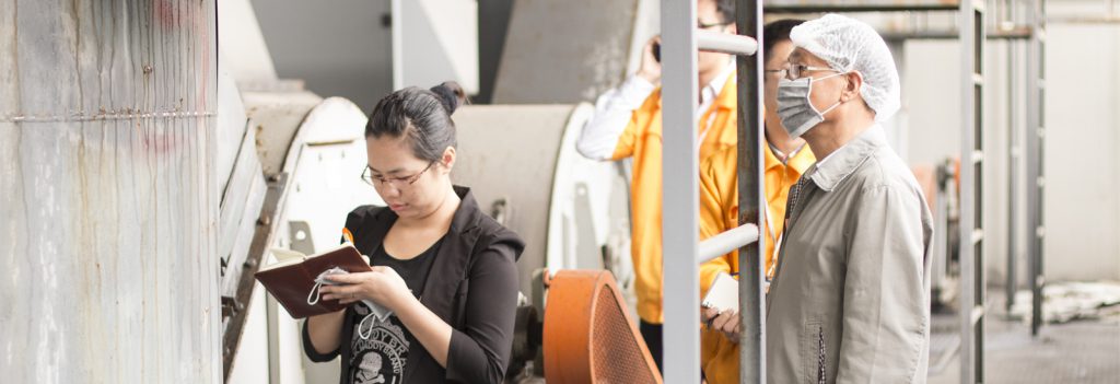

An assembly line in the Suzhou facility as a TAOS assessor observes the work being done.

Following up on the first assessment, Fairphone team members, most often our project manager Mulan, are regularly on-site to monitor progress. Lastly, TAOS will make additional unannounced follow-up visits to validate the status over the course of our partnership.
The Improvement Plan is expected to improve findings that require relatively simple fixes, like changing emergency arrows, providing protective masks, and installing eye wash stations. More importantly, however, the assessment also identified systemic and interrelated challenges, like fluctuating and sometimes excessive working hours. These issues require more time and commitment to bring about improvements from both Hi-P and Fairphone.
