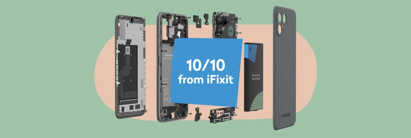

Last week at iFixit we did a teardown of the Fairphone 4, which earned an exceedingly rare 10/10 on our repairability scale. During that teardown, I was impressed with many of the decisions the Fairphone design team made. With repair legislation around the corner in most markets around the world (and already in effect in some places like France) there has never been a better time for smartphone makers to take a few notes from Fairphone 4’s design, and this company’s methods. Here are some that stuck out to me during our teardown.
#1 Make it modular
The most important message I can relay to smartphone designers—and users—is just how crucial modularity is to the longevity of any device. Modularity often dictates whether a device can be useful for an extra year or two, and how efficiently and effectively a device can be recycled at the end of its life.
A modular thing is one whose components can be separated and replaced individually, and the concept scales up and down with the size of different devices. You probably take for granted the modularity of larger everyday things, like cars or bikes. Imagine needing to replace your whole bike when the tires wear out, or pulling out the engine of a car to replace a headlight.
 No part of Fairphone 4 is glued shut, so you can choose to easily repair it yourself with a standard screwdriver.
Scale that concept down to smartphones, and you’re looking for modularity in critical components to a device’s functionality, such as the screen, cameras, ports, and battery. Fairphone 4 gives users access to all these components and more, in just a few simple steps, requiring only a Phillips screwdriver and their fingers.
